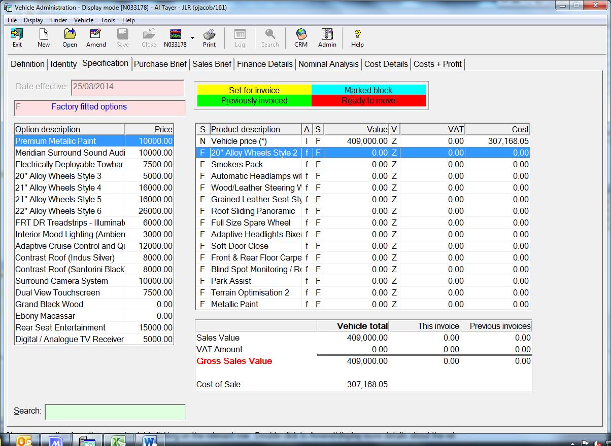

My program selects a record grid in a CRM software that is not editable.
I need to scroll down using the keyboard down key and the whole record gets selected.
Now I need the mouse to double click the selected record to open it in a separate form.
The return key does not work on this.
Kindly advise.

The whole record grid is an accessible object; however, the individual records are not.
What I need to accomplish here is to find and obtian all product description that involves a 'Value'. If value is '0.00' then goto next record and this needs to go on ofr as many records as is there in the record grid.
Kindly see the attached screen shots:
Best Regards,
Philip
