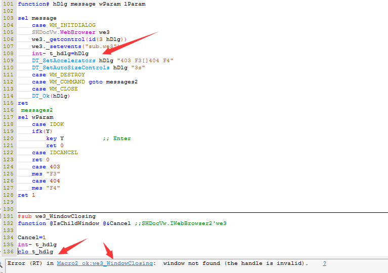

the error message is very clear your variable has no value so therefore will error every time because your saying clo 0
the reason is because your missing a declaration that assigns a value to that variable.
i'm guessing you removed that part from further up in the code
In its current state it's just an empty variable.
read more here
http://www.quickmacros.com/help/Language...ABLES.html
and here
http://www.quickmacros.com/help/Language/IDP_SCOPE.html
read section
Variables, constants, numbers, strings

Quote: In addition, I have defined four hotkeys, two in the main window and two in the child window. I often have hot-key errors.
__RegisterHotKey registers hotkeys that work in all windows of all apps, and fails if that hotkey is already registered by some app or some your dialog. Why not to use DT_SetAccelerators?
http://www.quickmacros.com/forum/showthr...2#pid31122 .

I modified the code to use DT_SetAccelerators instead of __RegisterHotKey, but F1 and F3 do not take effect. F2 clicks the OK button in the main window to close the main window. why?

Posts: 1,338
Threads: 61
Joined: Jul 2006
04-30-2018, 10:30 PM
(This post was last modified: 04-30-2018, 10:44 PM by Kevin .)
Take a little more time to understand how the function works id 1 and 2 are for ok and cancel buttons which you don't have in your dialog

The following error, I have been trying to find a solution, but the ability is limited, can not be resolved, I search a lot of code about the modal window in Google, can understand the meaning, but can not solve the problem in QM, No similar case was found on the QM forum. can you help me again?
Error (RT) in <open ":3040: /2759">Macro2 ok:we3_WindowClosing: window not found (the handle is 0). <help #IDP_ERR>?
Macro [b]Macro2 ok
[/b]
#sub we3_WindowClosing
function @ IsChildWindow @& Cancel ;;SHDocVw.IWebBrowser2'we3
Cancel= 1
int - t_hdlg
clo t_hdlg
1.What will be the functions of the accelerator keys?
Reply: Sometimes I need to click on a button in the eBook so I define a hot key to operate it
In QM, some simple operations are easier. For dialog boxes, I feel it is difficult to learn.
2.Are you trying have a list of links in 1 file then when you click a link in index html it opens in another dialog then have the second dialog close after a given length of time and return to the main dialog?
Reply: No, at the moment I only want to close the child window on the page (that adds the specific delay code) E.g:
<body onload="window.setTimeout('window.close()',3000)">
</body>
I don't understand why it can't be implemented, only close the current window, and the main window keep open

Again the error is because the variable has no value
Its saying close nothing which qm or any program would red flag and say no i can't do that with clo function
Please take more time to read qm help it will better explain how things work
a variable needs specific things in order for it to do anything for example
you cant just say
i=4
or
url="www.google.com"
and then use it
first have to declare it
int i=4
str url="www.google.com"
and also need to understand what the declarations mean
int is for numbers but only certain types of numbers
str can be many things
read again
help topics
in category Variables, constants, numbers, strings
this information is also built into QM itself under help
since your trying to close the child dialog need to first set the child dialogs window handle value to a variable in his case variable t_hdlg and pass that id to the child dialogs close sub function to the close the child window
#sub DlgProc2
function # hDlg message wParam lParam
, case WM_INITDIALOG
, SHDocVw. WebBrowser we3
, we3._getcontrol ( id ( 3 hDlg))
, we3._setevents ( "sub.we3" )
, int - t_hdlg= hDlg
, DT_SetAccelerators hDlg "403 F3[]404 F4"
, DT_SetAutoSizeControls hDlg "3s"
, case WM_DESTROY
, case WM_COMMAND goto messages2
, case WM_CLOSE
, DT_Ok ( hDlg)
, case IDOK
, ifk ( Y)
,, key Y ;; Enter
,, ret 0
, case IDCANCEL
, ret 0
, case 403
, mes "F3"
, case 404
, mes "F4"
Cancel= 1
int - t_hdlg
clo t_hdlg
then only the child dialog will close

It's a little weird , in actual use, many times, the main window and sub-window will still close at the same time
The following prompt appears:
window not found (the handle is invalid). <help #IDP_ERR>?
The first time I click on the link, the popup window closes automatically and it's normal.
The second time I click the link, the main window and child window will be closed at the same time
Macro1 no

Posts: 1,338
Threads: 61
Joined: Jul 2006
Didnt have that issue here. Maybe better to not use child dialog since your not passing anything back to main dialog.there are other options .cant tell for sure from error message what is rhe issue maindialog will close if error anywhere in the function code including sub function ect. The error mesaage has a click able link click it it will show the line that the error came from
Posts: 726
Threads: 99
Joined: Mar 2018
05-01-2018, 02:19 AM
(This post was last modified: 05-01-2018, 02:24 AM by win .)
On my windows 7 system, I can run it successfully only once. The second time ,All dialogs close at the same time
Posts: 1,338
Threads: 61
Joined: Jul 2006
05-01-2018, 03:22 AM
(This post was last modified: 05-01-2018, 03:23 AM by Kevin .)
I can confirm i am having the same problem. and same error 2nd time clicking link dialog2 handle is 0
Posts: 726
Threads: 99
Joined: Mar 2018
05-01-2018, 03:26 AM
(This post was last modified: 05-01-2018, 03:28 AM by win .)
Gintaras
Hello, can you help me? This feature is very useful for me,Thanks in advance
Posts: 1,338
Threads: 61
Joined: Jul 2006
05-01-2018, 03:39 AM
(This post was last modified: 05-01-2018, 04:24 AM by Kevin .)
change code to
Cancel= 1
int w= win ( "Dialog2" "#32770" )
clo w
Posts: 726
Threads: 99
Joined: Mar 2018
Thank you very much. It is working fine now.
