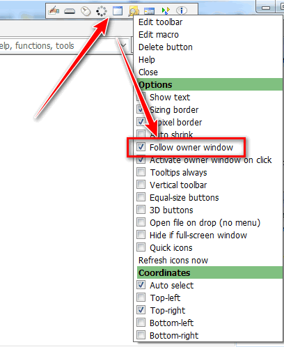

Can I add a button to the back of the toolbar icon?
You can create toolbars and add to any window, including QM.
I created a toolbar, but I can't set the "follow window", right click on the toolbar, there is no option to follow the window, but other tools have Huh
Please read in QM Help how to attach toolbars to windows.
