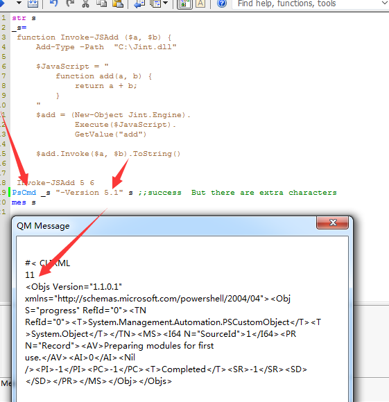

I used the above code to test that pscmd3 cannot call jint.dll
Macro PSrunjs
str s
_s=
;function Invoke-JSAdd ($a, $b) {
;;;;;Add-Type –Path  "C:\Jint.dll"
;;;;;$JavaScript = "
;;;;;;;;;function add(a, b) {
;;;;;;;;;;;;;return a + b;
;;;;;$add = (New-Object Jint.Engine).
;;;;;;;;;;;;;Execute($JavaScript).
;;;;;;;;;;;;;GetValue("add")
;;;;;$add.Invoke($a, $b).ToString()
;Invoke-JSAdd 5 6
PsCmd _s "-Version 5.0" s ;;success  But there are extra characters
;PsCmd3 _s "" s ;;failure
;PsCmd3 _s "-Version 2.0" s ;;failure
;PsCmd3 _s "-Version 5.0" s ;;failure
mes s
.zip   Jint.zip (Size: 96.91 KB / Downloads: 458)

Still can't output the result, I am using win7 system, powershell updated to 5.1
Below is an animated GIF demo
https://ibb.co/FJrM2kX
How to pause these animated gifs?
https://drop.me/BbRR4m
I turned GIF into video.

Strange, pscmd can output, But with extra code
The – before Path is some Unicode character, not true -. Replace it.
I do not understand
PsCmd _s "-Version 2.0" s ;;failure

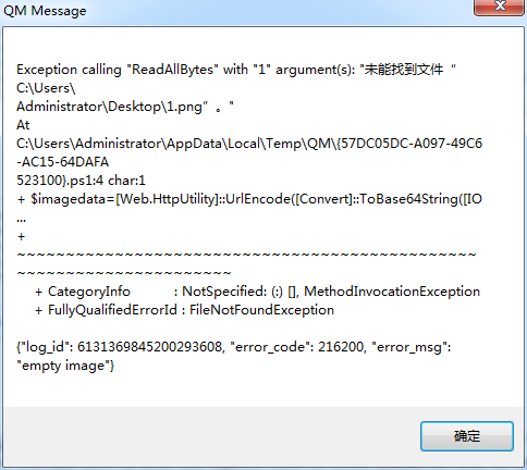

Run successfully using the code below
in the ps code, variable Cannot be included
 $pic='{s1.expandpath}';

Is there a solution? Smile
I tested your code with {variable} and it works without errors. Don't know why not on your PC. Result:
{"log_id": 1252041876708167624, "words_result_num": 0, "words_result": []}
Tip in the image upper right corner: File not found
The file path in the image lower left corner seems to be split in two lines.
I think in the Chinese version of the system, it should be escaping \n

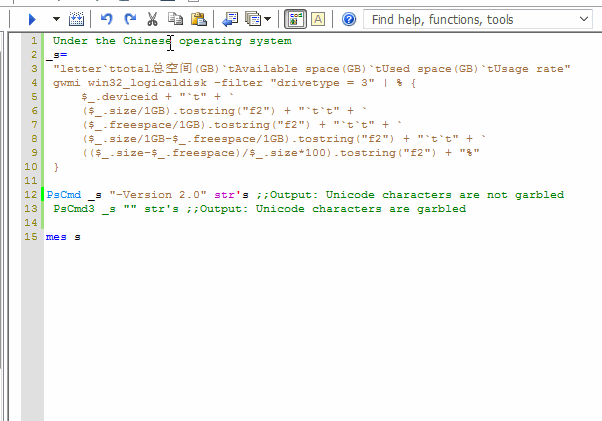

I found some rules again:
Under the Chinese system: pscmd can support unicode characters very well, pscmd3 will generate garbled characters.
Under the English system: pscmd and pscmd3 are not very good for unicode character support.
However, using powershell ise to execute the code, in Chinese and English systems, the output is always successful, there is no garbled
Because of the garbled, many of Powershell's code can't be used in QM.
Shy
Please see the GIF demo below
Macro Macro14
;Under the Chinese operating system
_s=
;"letter`ttotal总空间(GB)`tAvailable space(GB)`tUsed space(GB)`tUsage rate"
;gwmi win32_logicaldisk -filter "drivetype = 3" | % {
;;;;;$_.deviceid + "`t" + `
;;;;;($_.size/1GB).tostring("f2") + "`t`t" + `
;;;;;($_.freespace/1GB).tostring("f2") + "`t`t" + `
;;;;;($_.size/1GB-$_.freespace/1GB).tostring("f2") + "`t`t" + `
;;;;;(($_.size-$_.freespace)/$_.size*100).tostring("f2") + "%"
;PsCmd _s "-Version 2.0" str's ;;Output: Unicode characters are not garbled
PsCmd3 _s "" str's ;;Output: Unicode characters are garbled
mes s

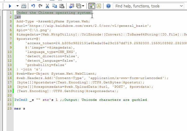

I added parameter 1 with the new version of pscmd3 but still garbled?
Shy
Macro Macro14
_s=
;Add-Type -AssemblyName System.Web;
;$url='https://aip.baidubce.com/rest/2.0/ocr/v1/general_basic';
;$pic='C:\1.png';
;$imagedata=[Web.HttpUtility]::UrlEncode([Convert]::ToBase64String([IO.File]::ReadAllBytes($pic)));
;$poststr=@(
;;;;;'access_token=24.b305c9822131e65eda05e29c157dd719.2592000.1559103982.282335-16139329',
;;;;;$('image='+$imagedata),
;;;;;'language_type=CHN_ENG',
;;;;;'detect_direction=false',
;;;;;'detect_language=false',
;;;;;'probability=false'
;) -join '&';
;$web=New-Object System.Net.WebClient;
;$web.Headers.Add('Content-Type', 'application/x-www-form-urlencoded');
;[byte[]]$postdata=[Text.Encoding]::UTF8.GetBytes($poststr);
;[byte[]]$responsedata=$web.UploadData($url, 'POST', $postdata);
;[Text.Encoding]::UTF8.GetString($responsedata);
PsCmd3 _s "" str's 1 ;;Output: Unicode characters are garbled
mes s
PsCmd3 _s "" str's ;;Output: Unicode characters are not garbled
Why?
Huh
;) -join '&';
str s
PsCmd3 _s "" s 1
mes s

Perfect solution, thanks for your help Heart
Powershell is much more powerful than vbs, a few lines of code to achieve the effect of dozens of lines of VBS code
More importantly, it can call the .net class library, omnipotent Tongue
your above code had garbled text because you didn't set the console  like Gintaras suggested
this line was  the difference between proper output and garbled text
[Console]::OutputEncoding=[System.Text.Encoding]::UTF8
Thanks for your explanation of the problem.
