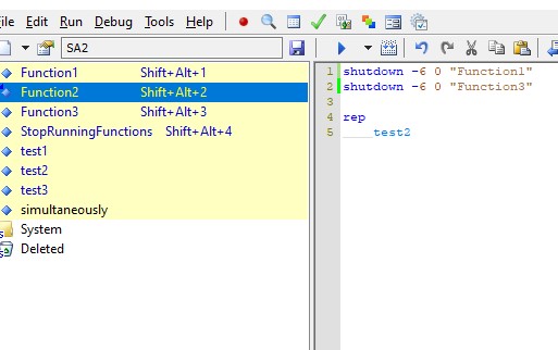

Thank you redbull2k,
now I now know that I can use shutdown -6 to stop a function, but everything else is confusing me even more and I can't see or understand what these snippets do other than starting or stopping functions or loops.
Sorry, but this doesn't help. Like I said before I'm not good at programming. The only thing I notice is, that there is no macro running these functions. The labels you used are only confusing me even more. It looks pretty random to me and I can't imagine how this could work.
I really took some time to try to understand the code and while I think that I understood a part of the concept, I'm not sure how to implement it in my macro to make it work the way i need it. I hope somebody can explain this to me.
Your help is very much appreciated! Thanks in advance!
First of all you dont need a macro to run Functions and they can be triggered by hotkeys. You will need to add the trigger field SA1 SA2 SA3 to the functions. That way when you press the hotkeys it will run those functions. I have only put one line code in there for you to see which has be fired by your hotkey and there you can enter your desired code.

What code do you have in your function 1,2 and 3
.qml   test.qml (Size: 5 KB / Downloads: 254)
Thanks! Now i understand a bit better.
In function 1, 2 and 3 i have some image scans and if then else going on. The thing is, that these are acutally macros but i want to clean it up because its getting more and more complicated. So i need to make them functions, called from a main macro (not only from hotkeys because i want more ways to trigger a function).
One of these macros is looking like that:
