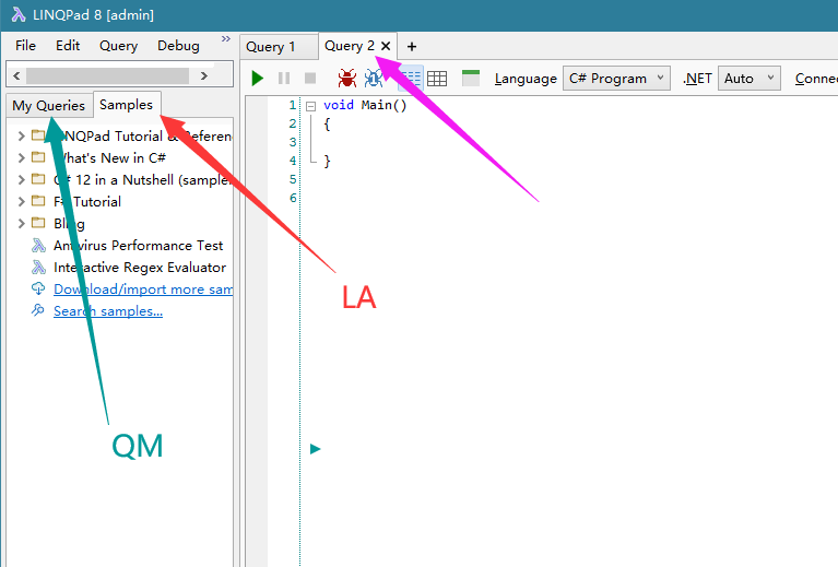

get name of the currently open tab
I need to get the name of the currently open tab in the Linqpad window (indicated by the pink arrow in the image),
The text obtained after executing the LA code (indicated by the red arrow below),
The text obtained after executing the QM code (indicated by the green arrow below).
Which tag should be added to solve this problem?
