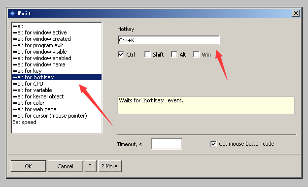

spe -1
Also nee to wait for window, now the code is too unreliable.
Suggest:
In the Wait for dialog box, add an option to wait for the hotkey, such as the picture below Smile
