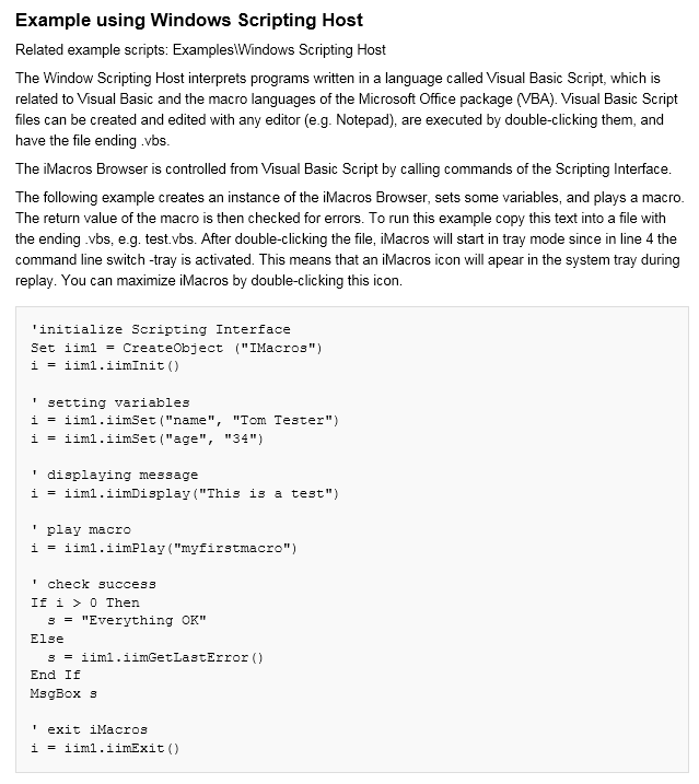

IMacros help in the document to see the following picture of the VB code, the code is VB scripting language calls iMacros the com components, how to use QM syntax calls COM components directly? looked at QM help, not very understand, hope You can write a QM example of the code, and the picture below to achieve the results of the implementation of the VB code is the same, thank you very much!

Macro Macro2732
IDispatch iim1._create("iMacros")
int i=iim1.iimInit()
;then the same as VBScript
or
Macro Macro2720
typelib iMacros {40658C29-4C34-4CA5-9596-8F852BAE27BA} 1.0
iMacros.App iim1._create

Modify the following code, the code can be completed, but the operation is not the same as the prompt, you can help me look at the situation, thank you
Operation video link:
https://youtu.be/j_P966QfAYU
int s
i = iim1.iimSet("name", "Tom Tester")
i = iim1.iimSet("age", "34")
i = iim1.iimDisplay("This is a test")
i = iim1.iimPlay("qm")
if i > 0
,s = "Everything OK"
,s = iim1.iimGetLastError()
mes F"{s}"
i = iim1.iimExit()

s must be str, not int. In QM there are many variable types, not just int.
#43
Successful implementation of the code, thank you very much for your support! Smile
