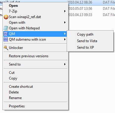

OK three unrelated more:
1. is it possible in shell menu to define an icon for top menu (not items)?
2. is there a way to remap keys as Fn ones on my netbook?
3. a way to start action on key press (say alt+A) and then different action press 1 alone after the sequence or
alt+A+1 directly...stuck in that.
tried to find for 1. did not search for 2.
1. Create new empty macro. Assign shell menu trigger with icon, and also check Submenu checkbox. The macro will be used only for the submenu and will not run.

Great news.
Excel cells filling for income tax time has come.....
Thanks for all.
Add items to it.
this is a submenu macro
Macro Macro1441
Trigger ^Shell_menu "QM submenu with icon" 0x8008 "" "$qm$\qm.exe,0"     Help - how to add the trigger to the macro
this is a macro in the submenu
Macro Macro1442
Trigger ^Shell_menu "QM submenu with icon\macro"     Help - how to add the trigger to the macro
function $files
mes files
Ok, what does the submenu thing do exactly, as i did not find help...in help section!
yes that is exactly what i want, plus an icon to submenus though.
Does your code do that?
Yes.
Create two macros, copy the triggers from my previous post, and paste in the Trigger field in the toolbar for each macro. Then right click a file in Explorer. You'll see a submenu with QM icon, containing 1 item.
If you already have a submenu, it is automatically created when labels of submenu items are like "Submenu Name\Item Name".
To add icon to the submenu, create macro for it. Name and text not important. Assign shell menu trigger. Let Label be "Submenu Name". Assign icon and check Submenu.

No menu appearing, and a message saying
Warning: trigger function Keyboard_2 not found. This trigger will not work.
Import this file.
.qml   shell menu trigger.qml (Size: 314 bytes / Downloads: 474)
OK, only the first one works, after i installed archive.qml from the site....
But the second one refuses to work
Keyboard_2 probably was an user-defined trigger downloaded from forum and later deleted. Probably some your macros have this trigger assigned.
What does not work?
Don't need Archive for shell menu triggers.
Keyboard_2, if does not work, probably is disabled, or in disabled folder.
OK, seems to work now, i was idiotic to check "submenu" property on the...submenu (aka 2nd item) menu.
Assigning an icon to the submenu does give an icon to it too.
QM is hard to tame sometimes.....
Thanks for your patience Gintaras, you're an angel
Thank you too.
Victory is mine (hmmm yours !!)
