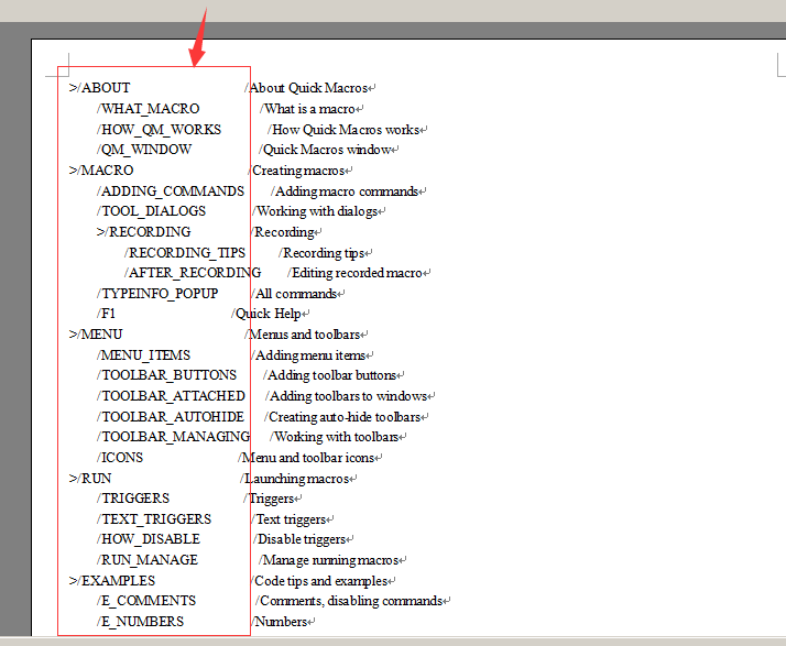

Need to highlight the rules are regular, for example:
1. There are / followed by a large letter
/ ABOUT
/ WHAT_MACRO

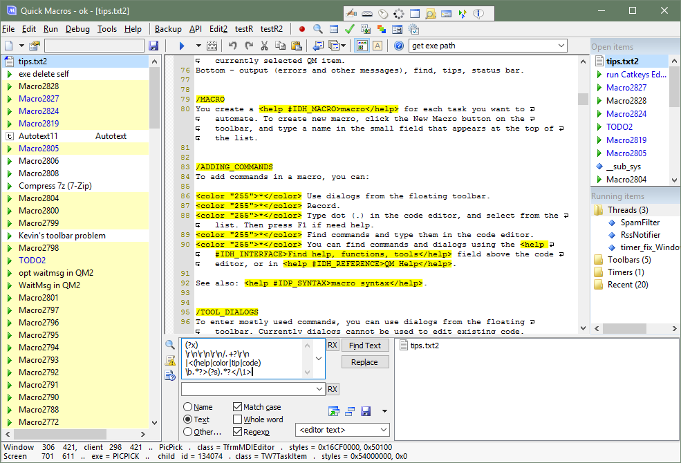

Why to use Word? Open tips.txt file in QM and replace these with the Find dialog using regular expressions.

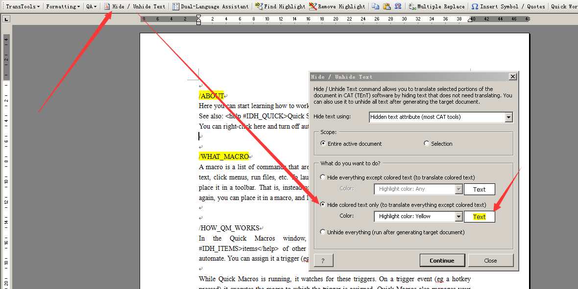

I copied tips.txt to the word, I just want to hidden the characters of the highlight content, And then into the translation software, translation of the characters of displayed, after translation, and then show the characters of hidden, The following tool can be hidden, showing the highlight of the content
http://www.translatortools.net/word-hideunhide.html
The following picture, the operation process
With professional software translation, I can use the machine translation engine very fast Tongue
If I do not hide the above content, the machine translation engine will translate all the content :oops:

Test success, QM is too great, but the following picture of the content, no highlight

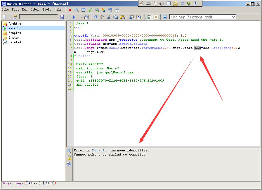

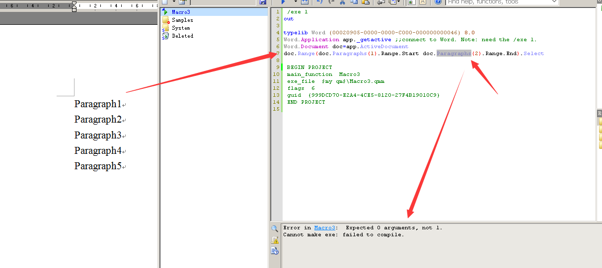

I would like to select three paragraphs in the word, but out of the following mistakes, I hope someone can help me look, thank you very much
Can I run the macro of created by VBA in QM? Smile
If someone makes a tool, I can convert the VBA macro into QM code, it's great Idea
Sub SelectRange()
Dim rngParagraphs As Range
Set rngParagraphs = ActiveDocument.Range( _
Start:=ActiveDocument.Paragraphs(1).Range.Start, _
End:=ActiveDocument.Paragraphs(4).Range.End)
rngParagraphs.Select
End Sub
kyjdp Wrote:I would like to select three paragraphs in the word, but out of the following mistakes, I hope someone can help me look, thank you very much
Changed the code, but unsuccessful :oops:
