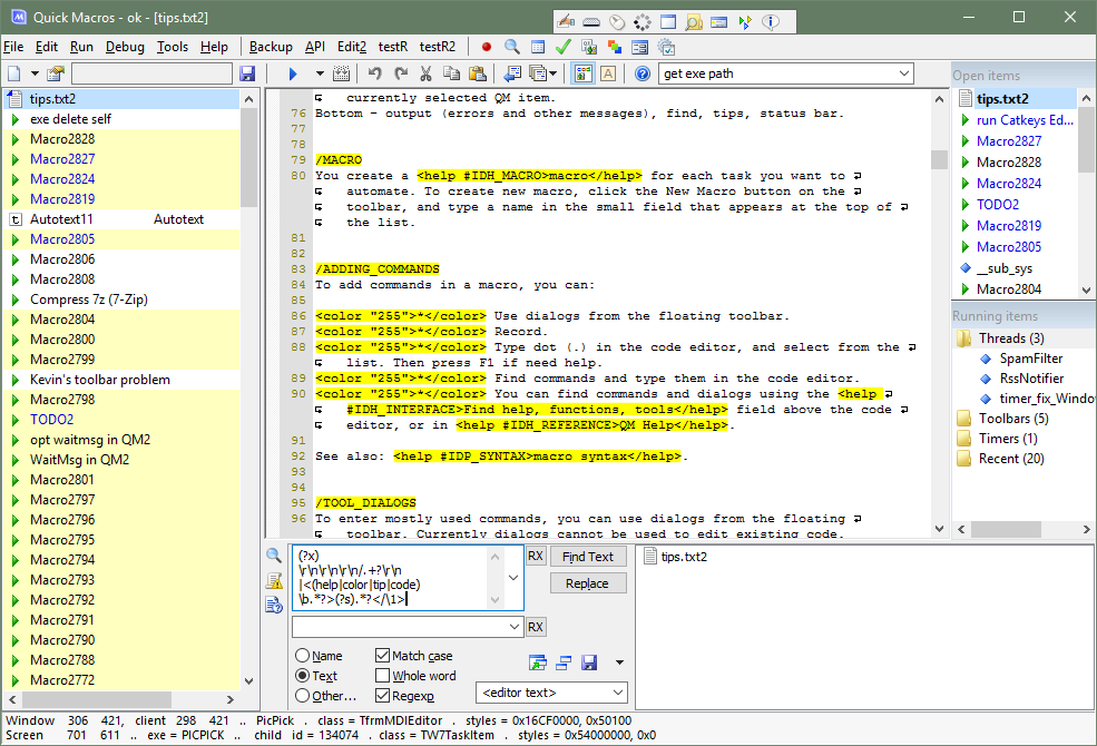

I copied tips.txt to the word, I just want to hidden the characters of the highlight content, And then into the translation software, translation of the characters of displayed, after translation, and then show the characters of hidden, The following tool can be hidden, showing the highlight of the content
http://www.translatortools.net/word-hideunhide.html
The following picture, the operation process
With professional software translation, I can use the machine translation engine very fast Tongue
If I do not hide the above content, the machine translation engine will translate all the content :oops:

Test success, QM is too great, but the following picture of the content, no highlight
