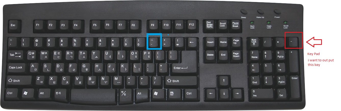

question about the key "-" dash
I have a question about the key "-"  dash
Can Quick Macro identity the dash"-" between keyboard  and keypad?
i mean the left hand side "-"  and right hand side "-"
for some reason, i need the QM output the key "-" must be from keypad (right hand side dash).
For example:
key "Abc - 1234"
the output is  Abc - 1234,  but the "-" is left hand side's "-"
please help to advise how to output "-" which is keypad (right hand side dash)
i will appreciate you if you can help me !!! Thanks!!
The same character, but the key code is different.
key N-
Thanks you so much!!
