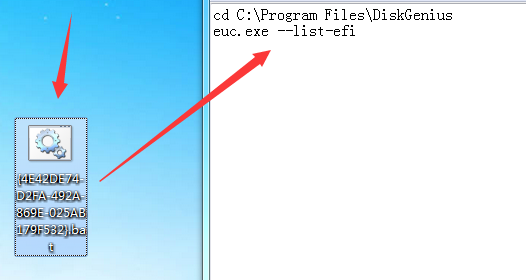

[b]Gintaras [/b]
how to "enclose"?
I found the generated temporary bat file
Posts: 12,150
Threads: 143
Enclose in double quotes like in my last example with RunConsole2.
