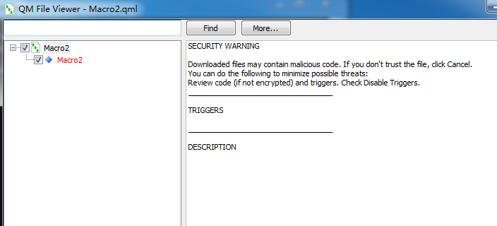

I created a run.bat file on the desktop with the following contents. In addition, the desktop also has a Macro2.qml file.
I double-click running run.bat can't support running macros, It will open the macro view dialog

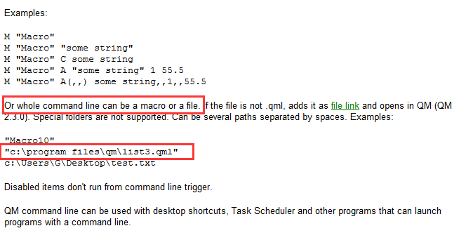

how should I write code? The following image is a description of the QM help file:

start "C:\Program Files (x86)\Quick Macros 2\qmcl.exe" "C:\Users\Administrator\Desktop\Macro2.qml"
pause
I tried a lot of methods, only calling the functions inside QM can succeed.
I hope someone can provide a way to run the external .qml file directly, thank you very much. Smile
Cannot run .qml files or functions from external .qml files.
