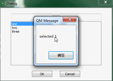

I just found out that by using the search results, using the carriage return or double-clicking on it, the result displayed in the dialog box is wrong. Huh
Please see the picture below
the code after Remove space, can solve the problem when typing, but lost the function of triggering the double-click event, It seems that this is the only way
mes F"selected {i4+1}" <---------------------thats why

If it still doesn't work there seems to be something wrong with your qm installation or your experiencing a bug that no one else has reported. I would suggest you to try and uninstall qm reboot pc then reinstall. Open a clean file and try code then. Because you cant seem to get any results or have errors from all functions that have optional function arguments. Something is definitely not right.
Still showing empty
I will reinstall the system later, thank you for your reminder.
I reinstalled the English version of the system, the test is OK
Is it related to the Chinese version of the system?
Huh
Below is an animated GIF
https://ibb.co/pnJ8pNg

you didn't test the correct code to see if the function would show the text as well
Can display text successfully, I really tested
But the optional parameters are not tested successfully, it is very strange

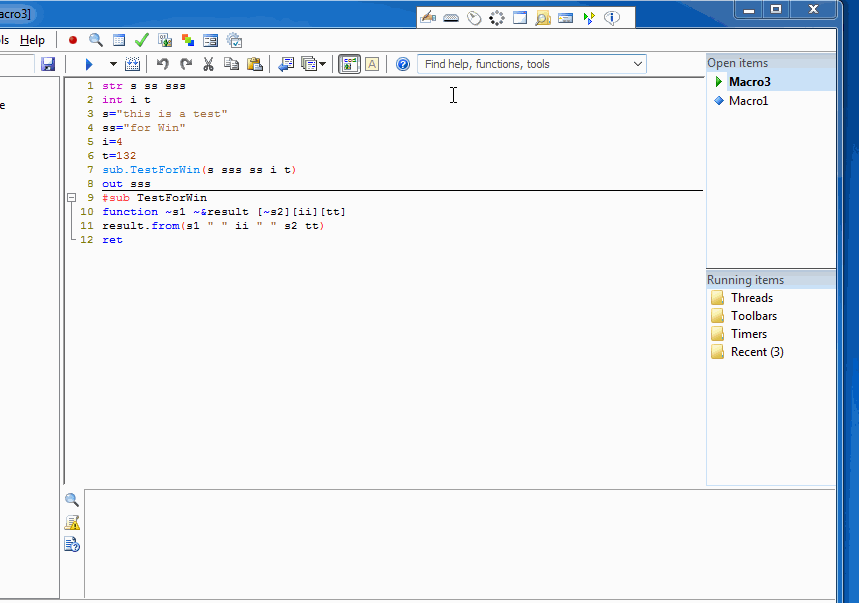

ok because the video only showed the numeric output. not the numeric output and text.
test this to see if it works
Function Function211
str s ss sss
int i t
s="this is a test"
ss="for Win"
i=4
t=132
sub.TestForWin(s sss ss i t)
out sss
#sub TestForWin
function ~s1 ~&result [~s2][ii][tt]
result.from(s1 " " ii " " s2 tt)
I just tested it again and can't output the text.  Huh

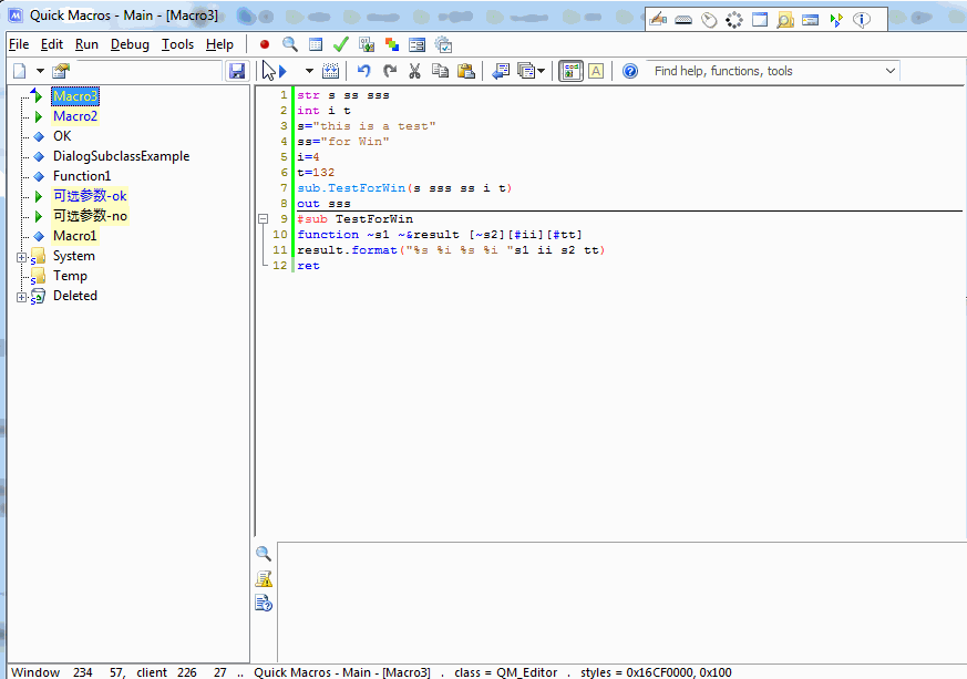

function ~s1 ~&result [~s2] [int'ii] [int'tt]
result.format("%s %i %s %i "s1 ii s2 tt)
lol @ google translate
Something is wrong .Qm should not be doing that..
Is successful
Very Interesting..
Qm is has code built in that if the variable is not defined it by default makes it an int
what about this?
str s ss sss
int i t
s="this is a test"
ss="for Win"
i=4
t=132
out sss
#sub TestForWin
function ~s1 ~&result [~s2] [#ii] [#tt]
Where is the problem? Is the result of my test the same as yours?   Angel
all 3 codes work for me.
That's too weird.  need to report the situation to administrator?
probably but try these First and see what happens
str s ss sss
int i t
s="this is a test"
ss="for Win"
i=4
t=132
out sss
#sub TestForWin
function ~s1 ~&result [~s2][#ii][#tt]
str s ss sss
int i t
s="this is a test"
ss="for Win"
i=4
t=132
out sss
#sub TestForWin
Unsuccessful
recompile them first the run again
Unable to use recompilation, prompt the same error as above
