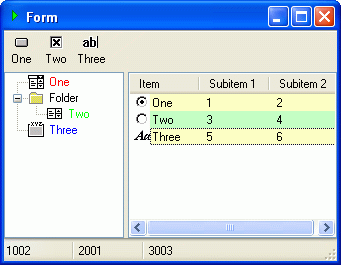

Explorer-style dialog
Sample dialog with toolbar, tree view, list view and status bar controls, with images.

can you tell how to make it work, so that we have text color
for tb buttons.
or is it the wrong attempt ?
i ask, because my toolbar now has the taskbar background, but the text
labels are black. Confusedhock:
DEX_TBCustomDraw
;/DEX_Main
function# NMTBCUSTOMDRAW*cd
sel cd.nmcd.dwDrawStage
,case CDDS_PREPAINT ret CDRF_NOTIFYITEMDRAW ;;yes, notify me to draw items
,case CDDS_ITEMPREPAINT
,,sel cd.nmcd.dwItemSpec
,,,case 1001 cd.clrText=0x222222;out "i am here"
,,,case 1002 cd.clrText=0x222222
,,,case 1003 cd.clrText=0xFF0000
,,,case else ret
pi
You probably know from custom draw documentation that not everything works if XP visual styles are enabled. Either disable visual styles for tb, or draw text yourself, which is quite difficult but possible (qm toolbars do it).
,SetWindowTheme id(3 hDlg) L"" L""
i do not understand.
i still don't know how to set the text color for my tb buttons.
and how to make the active button look like been pushed.
pi
Your DEX_TBCustomDraw is correct. Maybe button ids are different in your app, but it works well if called from DEX_Dialog, when visual styles are disabled (SetWindowTheme called).
Quote:and how to make the active button look like been pushed
Don't know, see toolbar button states in MSDN.
