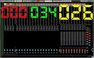

Dynamic OnScreenDisplay (Calculator like)
I want to have up to 3 numbers displayed on screen as typed which will scroll in the 3 numeric places from right to left ( like a 3 character calculator). The enter key will end the input stage and trigger the end macro/end display timer, with an auto end timer if no enter key hit within a certain time. Keys hit after enter will wipe the previous display. This seems to require a Few methods I'm not familiar with. Can you help me with this?

I realize I don't know how to do any of this - now I have a starting example. Thanks for the code.
This works well. A few points though; I'm building a display for buttons which aren't labeled (on a MIDI device), sending Ctr+Alt+Win+(1-0 and Enter), simply adding visual feedback for the keys hit (ie 1-9 and 0). - I have no Back/Delete key, so the numbers continually scroll/accept inuput, with the value not sent until the Enter key is hit. I use 0's to fill the digits with "empty" when I've made a mistake or don't know exactly what numbers were hit.
-How to make the numbers scroll/replace from right to left => once 3 digits are displayed, with each new digit added move existing to left?
-This is built with a dialog, but I was hoping to have it as a floating OnScreenDisplay (cleaner aesthetic), is this possible?
-After Enter, another timer instead of immediately killing the display?
Thank you for your assistance.

Wow...that's the dialog bible right there! What a great resource for folks just coming into QM! I really wish I had had that sitting around when I build my first dialogs!
Well, this Bible looks like it's still in Hebrew :?
I'm getting somewhere, but I'm getting frustration too.
-How to give the dialog set coordinates? I've been searching/trying, but all I can do is stretch the dialog or make it appear soemwhere not visible. I want to use 3 huge dialogs at the top of the screen - for MIDI Bank Select MSB, LSB, and Program change. I did discover DS_Center, but I can't define x y.
-How to trigger the code/run dialog - then populate with the triggering key (digit 1)? I'm presently using delays when converting MIDI to numeric to wait for the dialog to exist to send initial key but perhaps it can be simpler? I probably need the delay anyway to wait for the dialog to be enable. Do I need unique dialogs for each number?
-How to kill existing display before (re)opening another to prevent overlap? I'm using a font called LCD (11 segment calculator like). I didn't mention it but I've also got previous/next buttons to step throught the values, which can happen very rapidly. This is working, as the MIDI value is static [dialog(display -key 24- enter)] instead of dynamic [dialog(display -key 2- display -key 4- enter)]. When a program change occurs, the static value is converted into text, the dialog is opened, a delay, the text is inserted then enter. This works fine but the display looks "sluggish" as I have it set for a 2 second delay after IDOK. Killing existing dialog is actually necessary, as this MIDI translation method will open the dialog when Any Program Change is executed. I do realize I could use 2 dialogs, one dynamic and one static (dynamic IDOK no delay, static IDOK delay=(2) second). That way the dynamic would display numbers as typed, enter would immediately end that display, and instantly the static display would appear with the delayed close. Prv/Nxt would only trigger static display.
I Am learning something in all this... I realize you've given me bundles of info, I'm really in new territory and don't know how to understand a lot of it (yet).

I'd hoped to come back with flying colors, but no so yet...
The (DTN_Show) functionality is great. Dynamic entry is working properly as requested with a one caveat - the Enter key doesn't end the input stage/reactivate previous window. That may ease the difficulty I'm having (re)allocating static entry which isn't coeexisting with dynamic now. I've been poking around attempting a fix with varied results. I think Enter ending input will help as a type of footer message - I'm deactivating the dialog effectively as below, but it seems Enter should have a more discreet action. Canceling the dialog returns to previously active window as expected.

The above method works well enough for dynamic entry, but my previous method for static entry is unreliable - after Enter new numbers are often appended to an existing dialog before it's timer closes. I'm dealing more with the triggering process now, which is nearly a different matter, but it should be the final stage.
Just to note, an MSB message will 'bang/display' LSB and PRG, and an LSB message will 'bang/display' PRG, which are static input functions. I also need to build a trigger to bang/display MSB LSB PRG to see all present values, all static mechanisms (but not exactly what I asked for originally.) I originally expected I'd be able to "easily" adapt code for all this, but I overestimated.
Below is an example of a digit trigger for reference. I'm open to any suggestion.

If you test the below attachment you'll see the difference between using the (Q) vs Enter then typing in new numbers.

I apologize for all the requests, and I really thank you for all the efforts. I ended up reverting to the last Dialog method, as that was far easier to allocate than the OSD way, only to realize that the Dialog system is nearly perfect. The problems I'd been having all stemmed from the timing of the auto static keys input execution from the MIDI to text conversion. I haven't perfected it all quite yet, but It's just a matter of - time.
Again, thanks for all you've done, your coding is immaculate, I'm always impressed.
