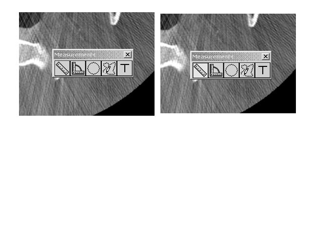

I'm having trouble finding if a button is pressed within a floating toolbar (see file attached) I would like my macro to detect if the ruler is pushed, and if so click the button to deselect. If not pushed, then the macro does nothing. I first tried using control-specific actions:

Thanks for your quick reply. The object property state says "focusable", see image below. In the code below, the PRESSED condition is never met:

It seems buttons here are not accessible objects.
Other way - find image.
if(scan(...))
,lef
Works like a charm, thanks so much!
