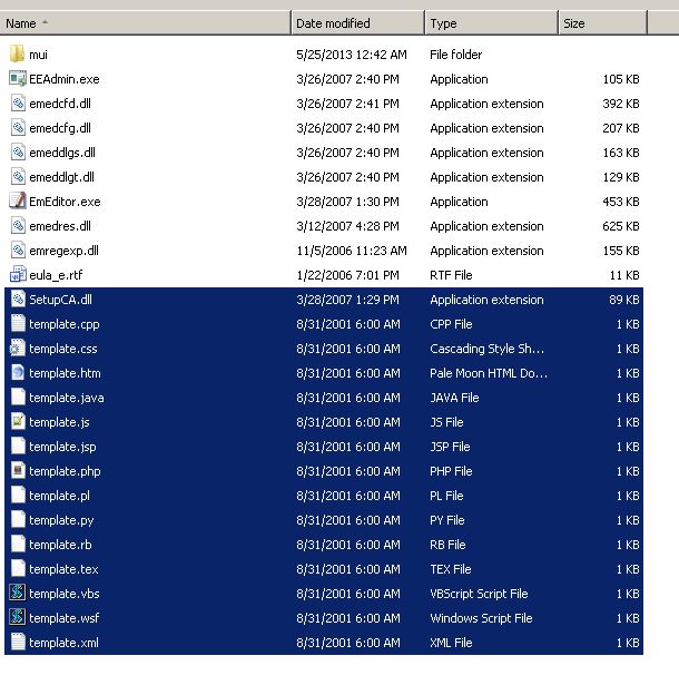

		I tried opensavedialog. but it's not what I intended.
I'm trying to select multiple files inside windows explorer like this...
and then I need to get the filename + extension for each of the selected files.
