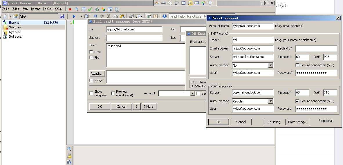

My mailbox for the following settings, debugging error occurred, I would like to ask where the wrong settings, I hope to be able to point it out, thank you
Now change the port settings, prompted the following error, I did not find the option of TLS, I hope to be able to point it out, thank you

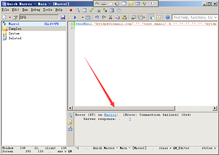

Error (RT) in <open ":1: /0">Macro1: [Error: Negative or void server response] (0x7A)
Server response: 530 5.7.0 Must issue a STARTTLS command first
For example, gmail uses TLS, and my settings are:
SMTP port 465, checked secure connection. Server smtp.gmail.com, method LOGIN.
POP3 port 995, also checked. Server pop.gmail.com.
