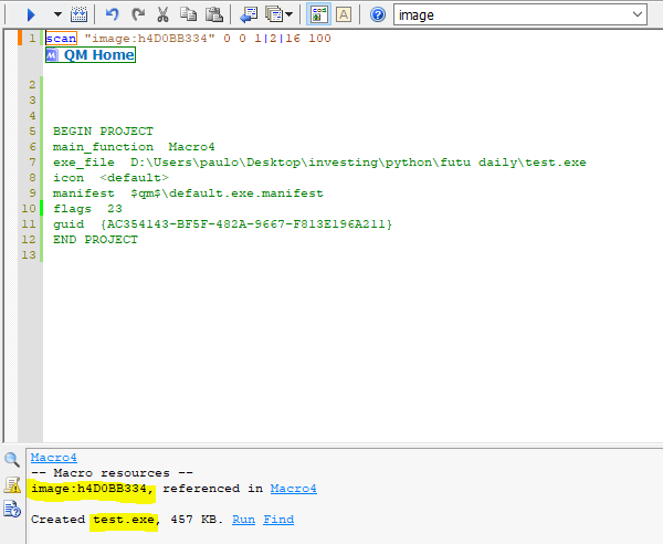

So, my script is to search an image and point to it if it's found. It works perfectly while clicking the run button. However, when I make it to exe, I can not find the same image and gives me error. I went back and click the run button again and it is fine.

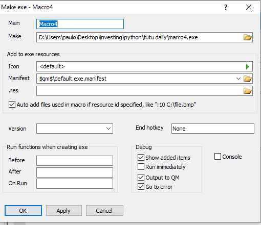

While making the exe, I also click the "auto add files used in marco if resource id specified.

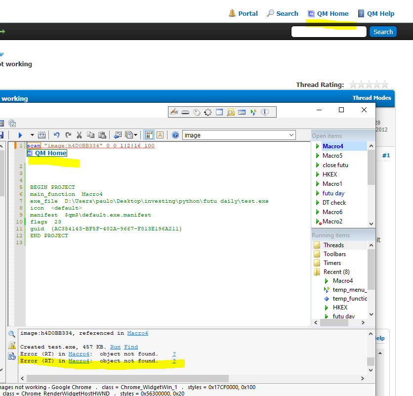

Here I make sure the image is uploaded, but i still get the "object not found" error. Can somebody please help CryCryCryCry
The same works here.

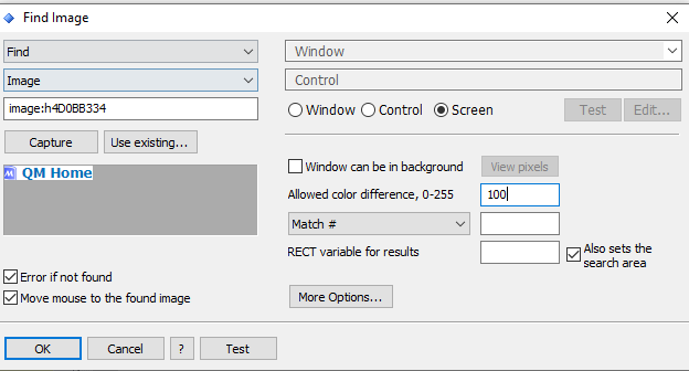

In "Find image" dialog the text field above "Capture" should be empty. Just capture and OK. Now I suspect maybe image:h4... is some previously captured image. And don't need "Auto add files...".
