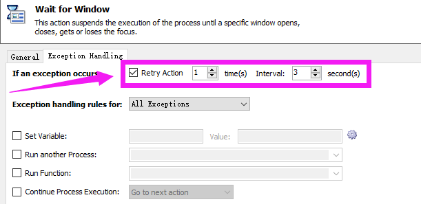

Recently, some of the issues I encountered seem to be related to execution speed. When errors occur, simply retrying once can resolve them.
Could we add a retry count attribute for certain functions as shown in the diagram below?
Although achievable with try...catch, it's a bit cumbersome.

It would be very convenient if the details were hidden, for example, by directly using the following code,
wnd.find(0, "*Notepad").retry(2, 300); //retry 2 times. every 300ms
